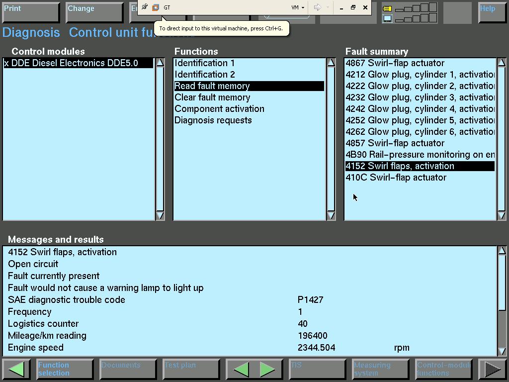

O scurta descriere a rolului si functionarii acestor clapete (pt DDE 5.0, dar cred ca si la celelalte e la fel) :
Swirl flap control DDE 5.0
The adjustable swirl flaps are located in the tangential channels of the intake system and are opened and
closed according to the operating status of the engine. The swirl flaps are closed under the following
conditions:
# at low engine speeds and low injection volumes (map-controlled)
The swirl flaps generally remain open when
# the coolant temperature < 15°C OR
# the intake air temperature < 15°C
Function
The pressure converter connects the vacuum unit with the vacuum supply by means of hoses. When
activated by the DDE control unit, the changeover valve switches vacuum to the vacuum unit. The vacuum
unit actuates the control rod and the swirl flaps close. The control rod is up against the rear stop when the
swirl flaps are open.
Troubleshooting
If a fault is detected in the control of the pressure converter, the following faults may be detected:
# 4130, Activation short circuit to B+
# 4141, Activation short circuit to B-
# 4152, Activation circuit break
# 4153, Excess temperature output stage
Effects of faults
If the swirl flaps stick in open position: Deterioration in exhaust gas characteristics in lower speed ranges
otherwise no effect.
If the swirl flaps stick in closed position: Power loss of approx. 10% at higher engine speeds.
Din pacate, blocarea clapetelor nu este semnalizata la bord auditiv sau vizual de nici un martor. Se poate evidentia prin diagnoza computerizata, dar atata vreme cat ti se pare ca masina merge bine, nu prea iti vine "sa o pui pe scaner". Si te pomenesti cu clapeta si boltul respectiv in cilindru...
