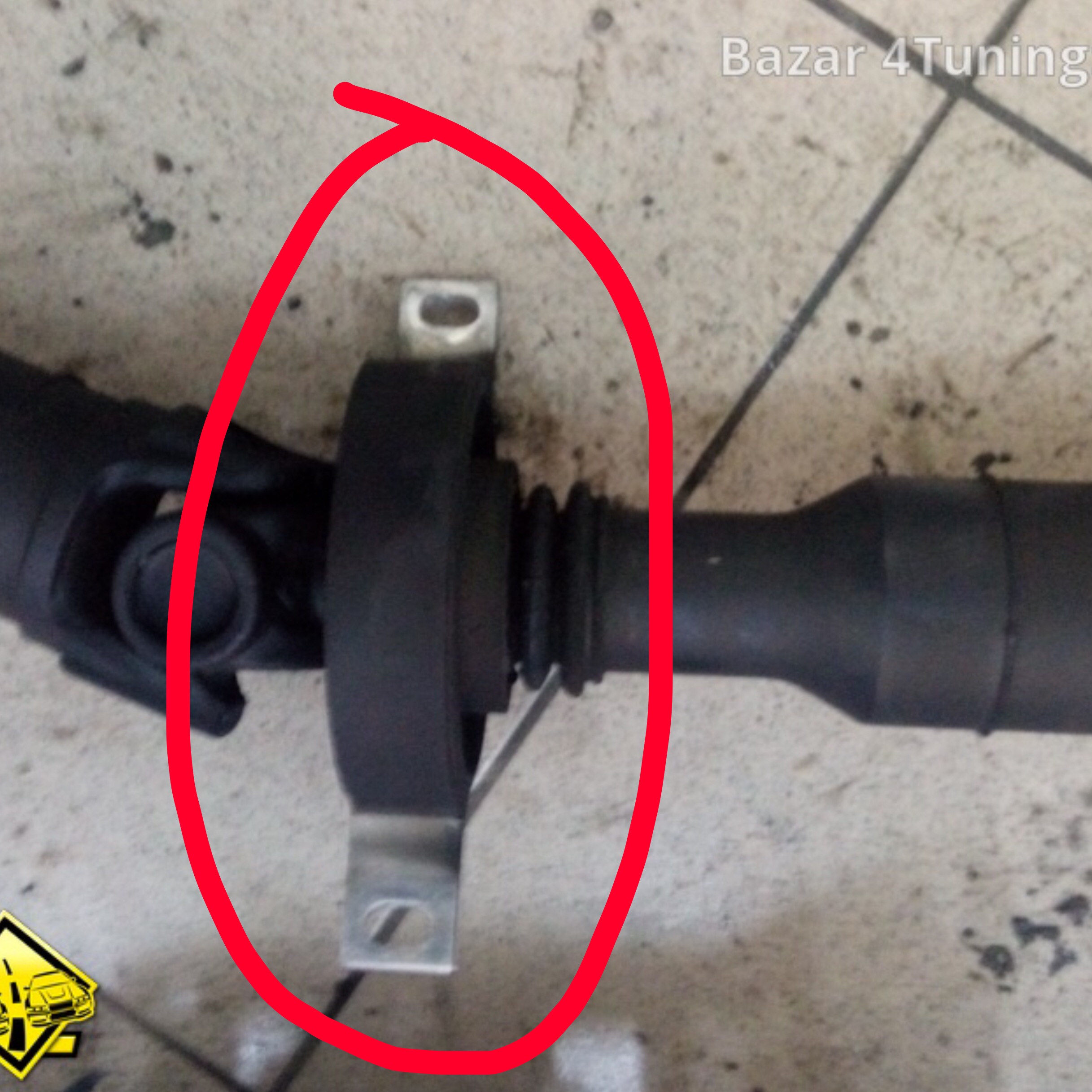

  • Location
    Brasov - Baia Mare
  • Interests
