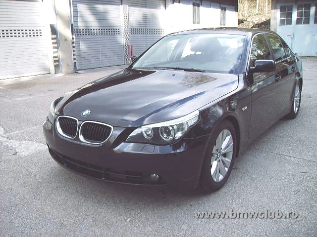

asa arata masina acum 6 luni

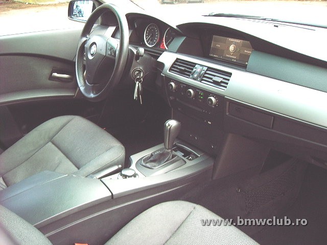

asta e interiorul (acum 6 luni)

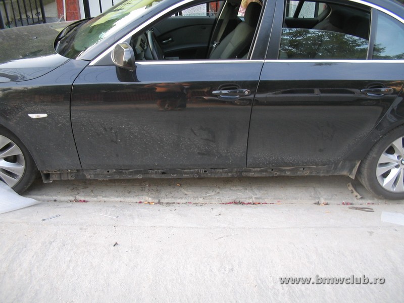

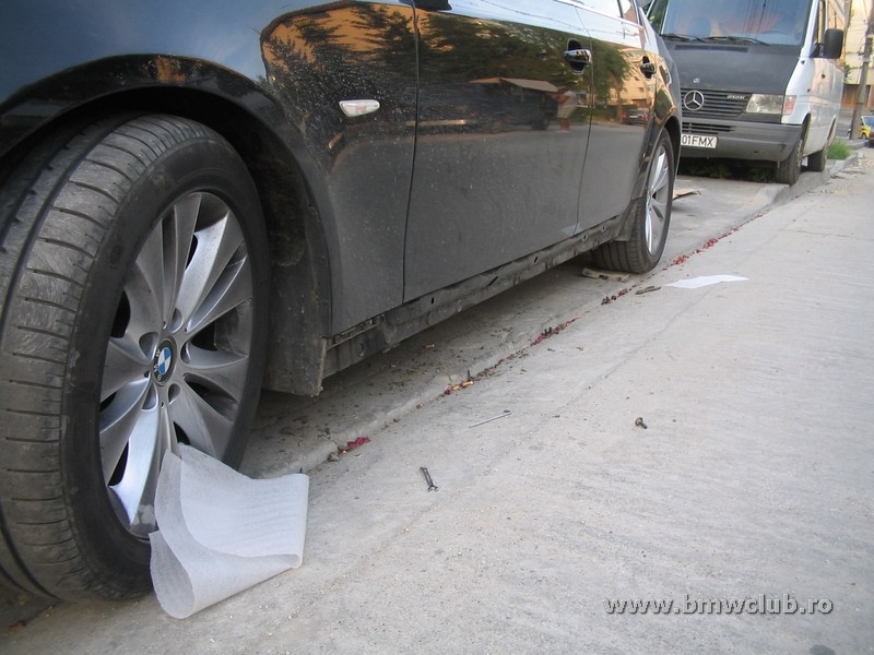

post-560-1169320830_thumb.jpgpraguri ...se schimba
post-560-1169320887_thumb.jpg si se tot scimba
post-560-1169320943_thumb.jpg saraca masina..
post-560-1169321022_thumb.jpgii sta bine asa..cred

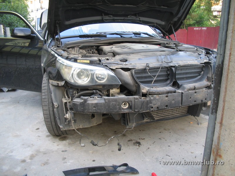

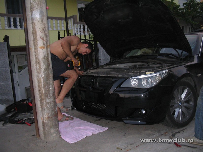

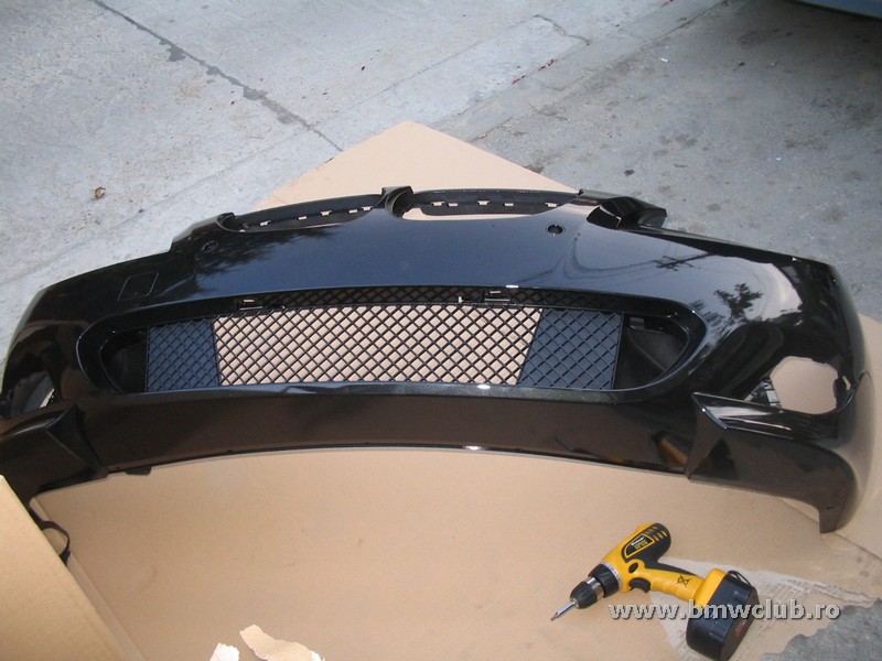

post-560-1169321182_thumb.jpgnoua bara paket m(prima)
post-560-1169321255_thumb.jpgtraiasca filetanta(AM SI DE VANZARE laugh.gif JUR)

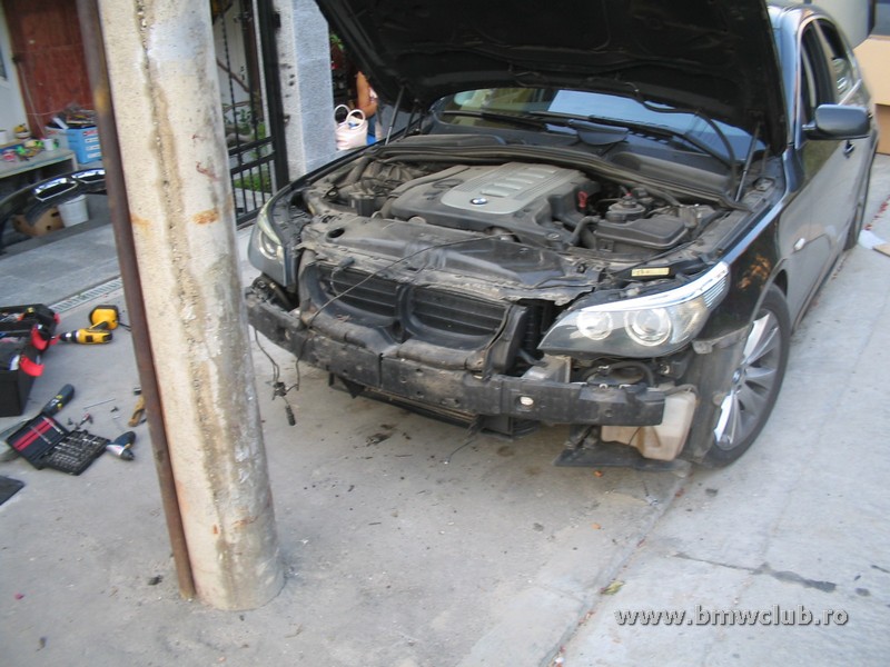

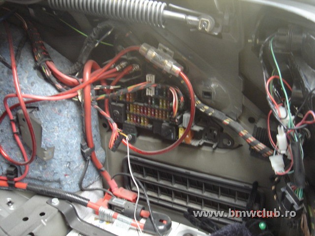

post-560-1169322222_thumb.jpgacolo e ......un panou de sigurante
post-560-1169322265_thumb.jpgbateria...si lgarea la un mic +
post-560-1169322341_thumb.jpg fire la kg
post-560-1169322438_thumb.jpgam aflat pra tarziu ca exista clasti care dezizoleaza :)
post-560-1169322526_thumb.jpgnu va speriati ca nu are decat 17 fire :D
