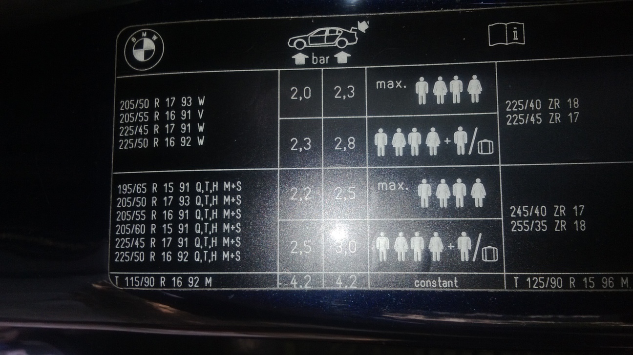

In certificat am si de 15 . Masina e 316 i facelift.
