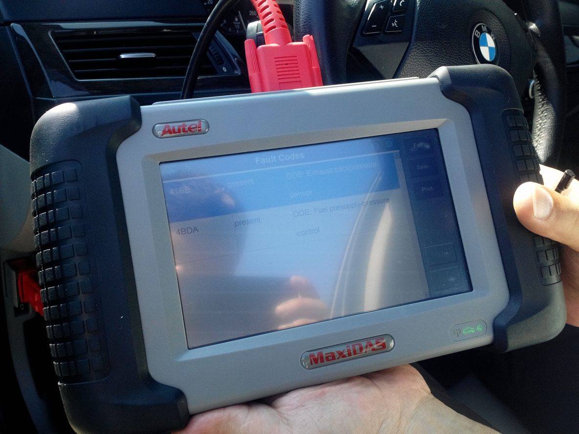

Prima imagine :
41BB - DDE: Exhaust backpressure sensor
4BDA - DDE: Fuel Pre-Supply Control

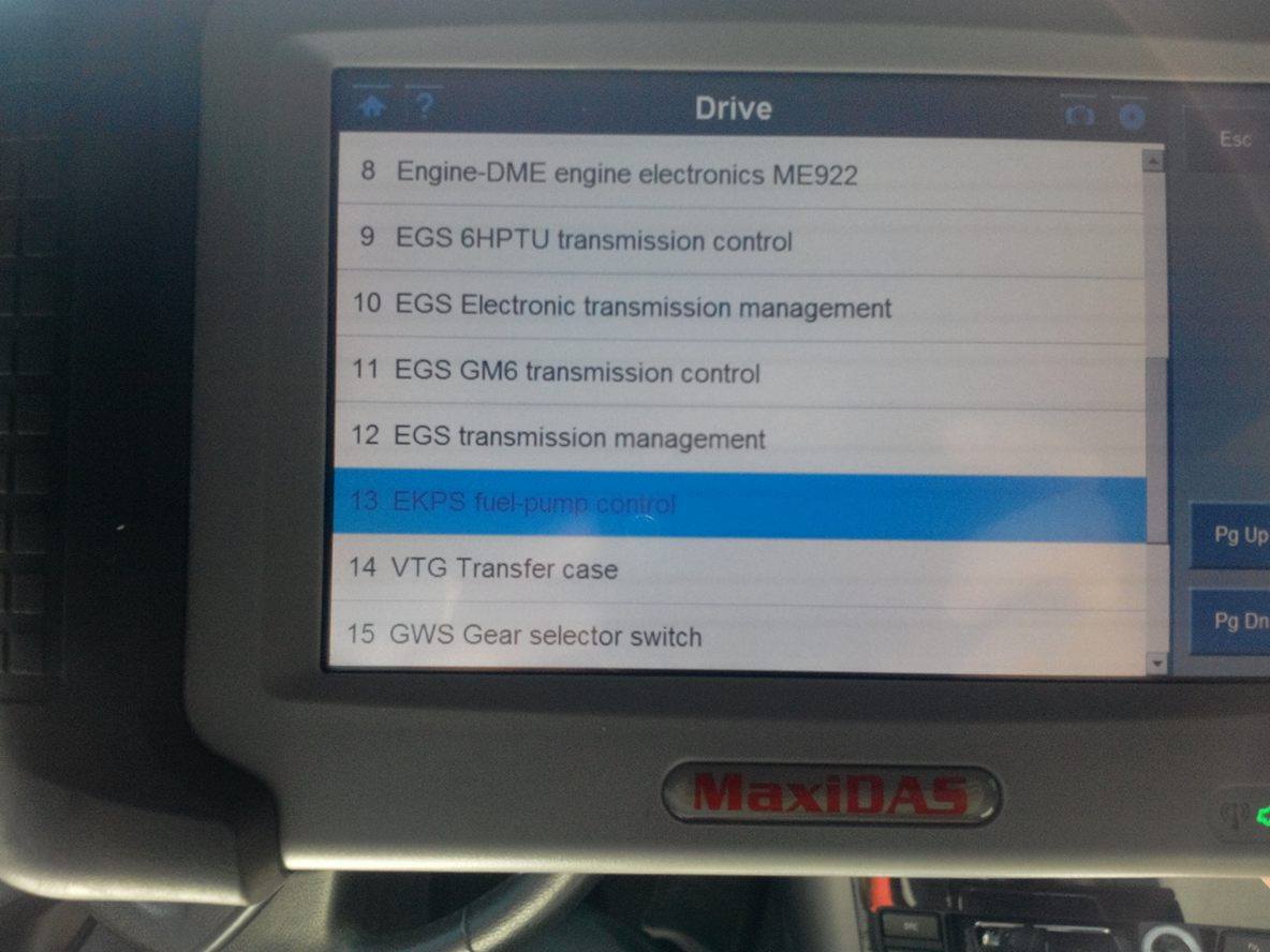

A doua imagine in sectiunea : EKPS fuel-pump control:
6292 - EKPS: Control voltage too low
Ce semnifica acest EKPS fuel pump ? A intampinat careva aceasta problema ? Sa aibe legatura cu aceasta pornire/oscilatii? Multumesc anticipat !
