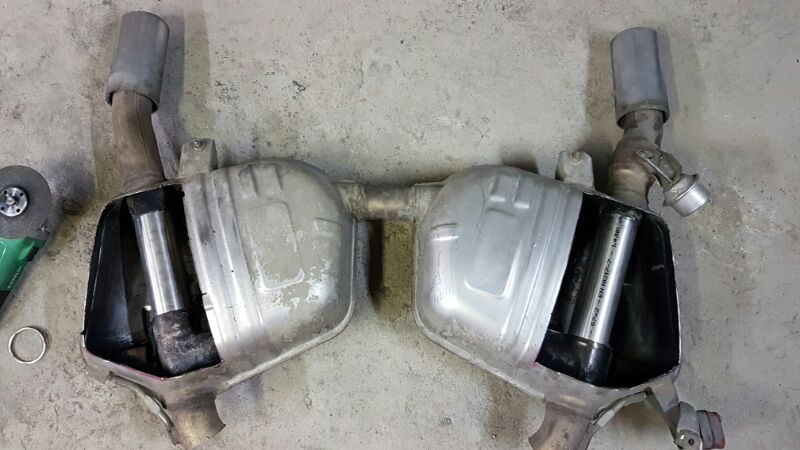

Ma tot uitam pe alte site-uri externe ptr o evacuare M-Performance și am gĂŁsit un DYI ptr a modifica evacuarea stock..prima data am fost puțin cam sceptic,dar am zis sa ĂŽncerc,oricum nu aveam ce pierde..M-am apucat de treaba și am urmat exact pașii descriși ĂŽn acest video.
Practic,am eliminat acele țevi perforate care se afla ĂŽn compartimentele duble exterioare ale evacuĂŁrii cu țeavĂŁ de inox completa, iar rezultatul este WOWW!!Diferența de sunet este evidenta când o urc ĂŽn ture...simfonie mecanica :)
La rugamintea multora,un user care avea o evacuare M-Performance a desfĂŁcut doar partea de pe partea pasagerului,ptr a vedea care e diferența dintre M și una stock..Diferența e ca cea M nu are nici o țeavĂŁ perforata iar cantitatea de insonorizant e mai putina.

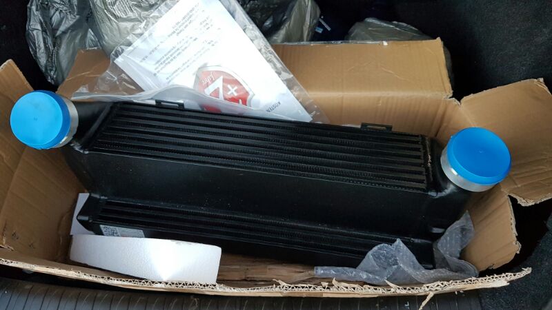

New upgrade,Wagner Evo intercooler.
Aici sunt câteva detalii despre acest model:
This Performance intercooler has the following core size (520mm x 200mm x 150mm / stepped = 13.000 cm³ ), providing a 50% larger frontalarea and 70% more volume compared to the original intercooler. Our engineers have increased the intercooler core size and efficiency, as well as improved the end tank design to remove any OEM bottlenecks, resulting in increased flow rating and charge cooling properties. High-performance Intercooler core with turbulators in a stepped design (weight: 9,2kg). Constructed of the highest quality Bar and Plate intercooler cores combined with cast aluminum optimized by CAD. Flow analyses and simulations were created to optimise the design for best possible Internal Airflow. This intercooler is the best choice when it comes to performance gains and low intake temperatures. A lot less pressure drop then OEM Intercooler. Anti Corrosion protective Coating with perfect thermal heat dissapating character. Optimal cooling with clearly more power. Kit is ready for installation (plug & play), using the stock plumming. No cutting or bumper removal required. Fitment is easy, replacing the OEM intercooler. All of our products undergo rigorous quality control.

Foarte buna alegere cu intercoolerul de la Wagner.
Inca cateva modificari si te indrepti spre ~600HP. :)

Imediat dupĂŁ instalarea IC-ului am ieșit ĂŽn probe,sa vad dacĂŁ se simte ceva la roata...chiar se simte,iar acest upgrade ĂŽși merita pe deplin banii.Montajul a durat 10 min,practic sunt doua șuruburi și doua c-clips care conecteazĂŁ cele doua conducte care intra ĂŽn IC.Am instalat o harta(MHD FMIC V7.1 99 Octans) optimizata ptr acest upgrade,iar rezultatul e pe mĂŁsurĂŁ.

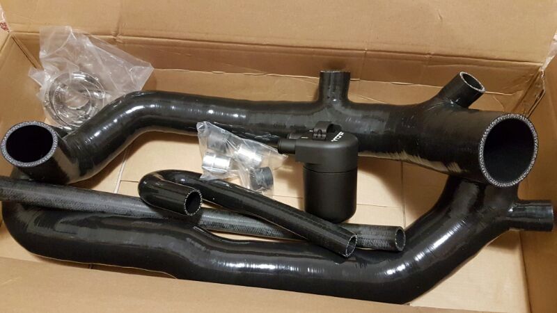

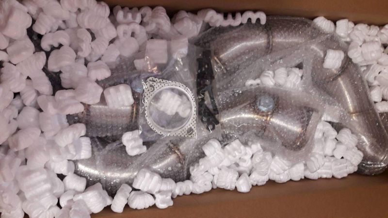

Asa,de sfarsit de an.. new inlets (tubulatura turbo) +oil catch can
Am tot citit review-uri legate de inlocuirea celor OEM si chiar se merita investitia,castigul fiind un raspuns mai bun al accelerației,ceva caluti in plus (40cp?) si un sunet al motorului mai sportiv.Daca tot umblu la tubulatura,am zis sa adaug si un Oil Catch Can tot de la VRSF..montajul il voi face saptamana aceasta,sper,apoi o voi pune pe dyno.
In plan mai e achizitionarea unor downpipe-uri si pot spune ca e FBO (full bolt on) cum spune americanul,iar puterea ar trebui sa fie undeva la 460cp.Turbinele OEM suporta maxim 500cp,peste aceasta valoare e nevoie de un upgrade turbo...

Am in plan destule update-uri,dar din pacate nu prea am timp,mai tot timpul plecat.Nu am avut timp sa montez aceste inleturi,urmand sa le montez odata cu downpipe-urile.Stau toata ziua pe ebay ,poate gasesc pe cineva din Europa care vinde asa ceva ptr ca din state transportul ajunge aproape la valoarea produsului.Pana pe 20 Februarie,cand ajung in tara am timp sa caut,poate gasesc convenabil.
