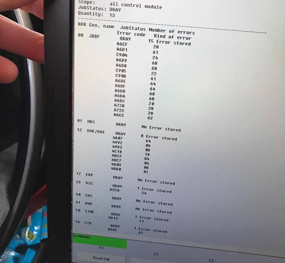

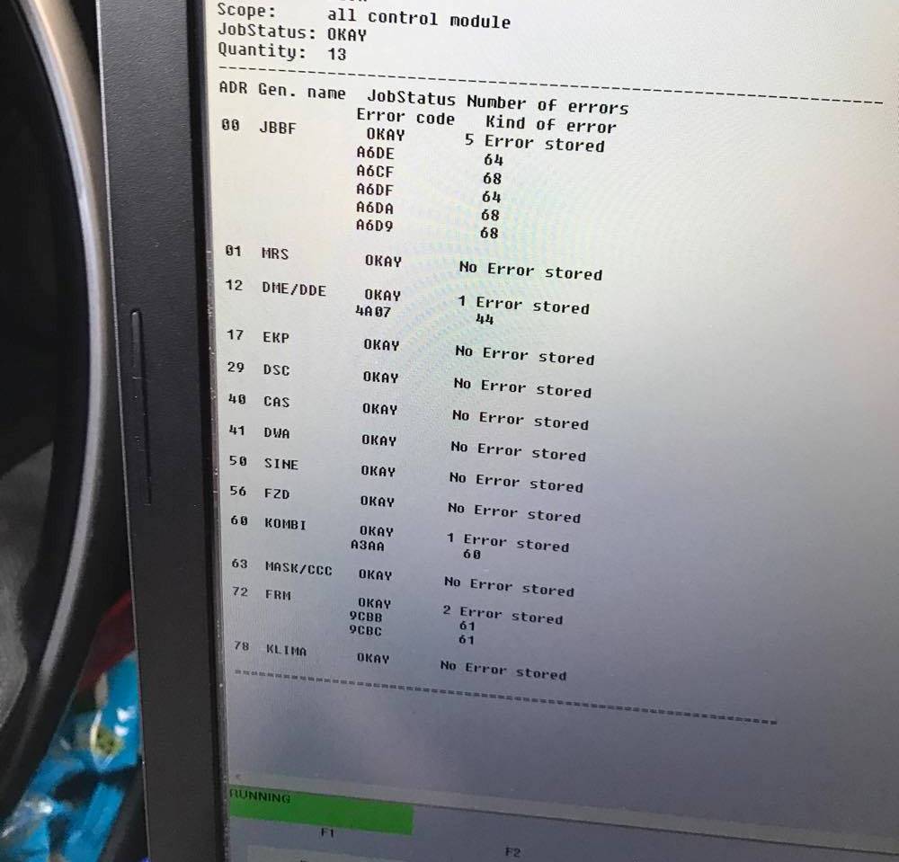

Am facut azi dimineata o diagnoza. Poza cu multe erori este cu erorile care au aparut la inceput, cealalta este cu cele care au ramas dupa ce am dat clear.
Mentionez ca ma intereseaza momentan sa le rezolv pe cele de la jbbf, de la restul stiu de ele si nu e graba.

am revenit. am instalat insta-d, dar nu imi face conexiunea nu stiu de ce, am reusit in schimb sa fac diagnoza cu inpa exact pe module si am gasit asa:
Variant: JBBF87
RESULT: 3 error in error memory !
A6DA relay FH back driver close
Error counter: 1
Logistic counter: 40
Mileage 208096 km
Speed 0.00 km/h
battery voltage 14.15 volt
Implausible signal or value
Test conditions fulfilled
Error present now and already stored
Error would not cause a warning lamp to light up
Error code: A6 DA 68 00 01 28 65 9C 00 00 01 FE
A6D9 relay FH back passenger open
Error counter: 1
Mileage 208096 km
Speed 0.00 km/h
Error code: A6 D9 68 00 01 28 65 9C 00 00 01 FE
A6CF sensor AUC
Error counter: 1
Mileage 208096 km
Speed 0.00 km/h
battery voltage 14.09 volt
Error code: A6 CF 68 00 01 28 65 9C 00 00 01 FC
help would be apreciated. thanks
