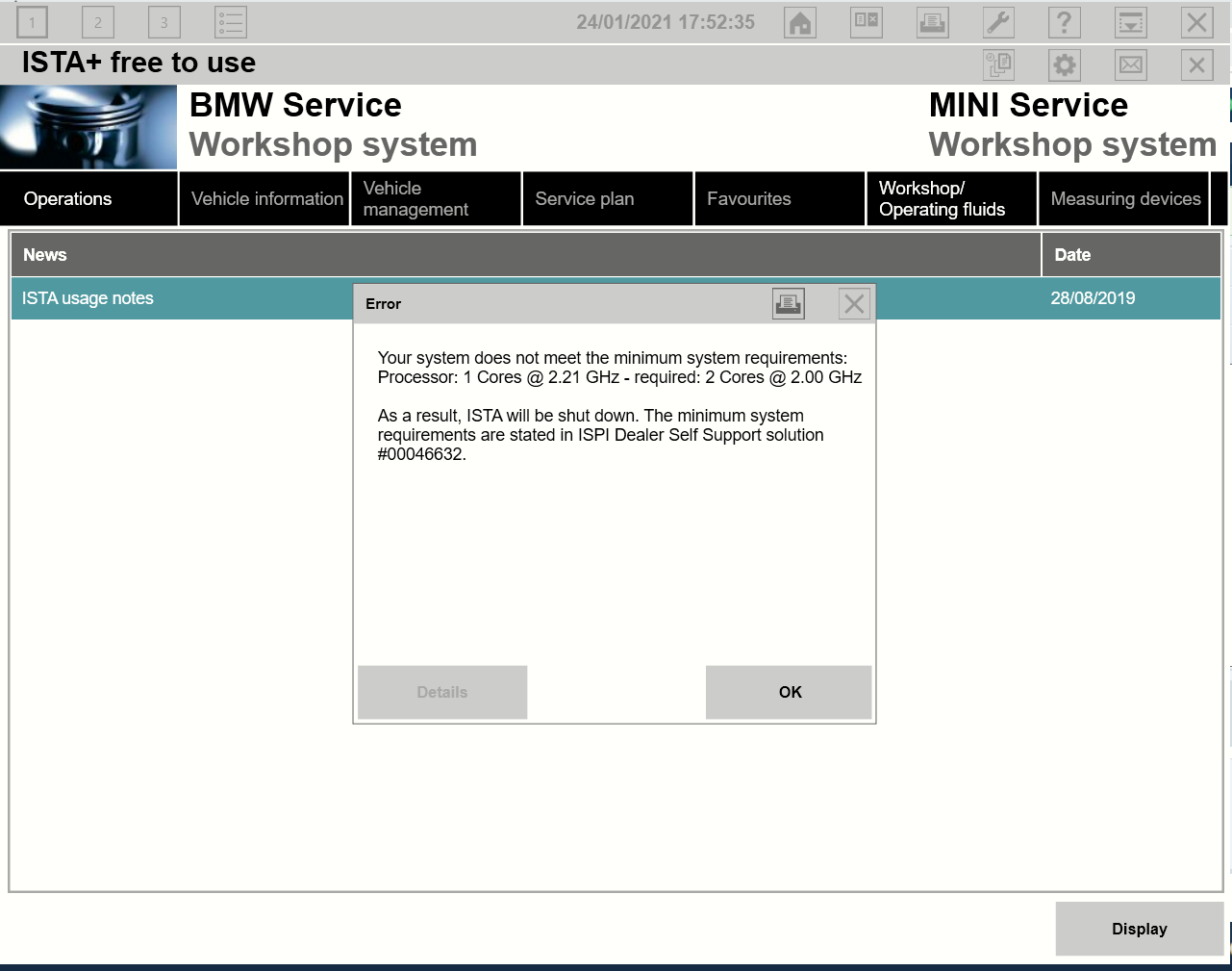

Salutare,
Am facut 4.25 sa treaca peste. Am modificat in registrii ca sa nu mai faca check system.
Am gasit instrunctiunile:
ISTA Standalone
* resolution can be changed in the ISTAGUI.exe.config
* disable CheckSystemRequirements is now possible in ISTAGUI.exe.config
* enable programming with ENET is now possible in ISTAGUI.exe.config (at your own risk.)
* enable Diagnose for J29 (Toyota Supra) is now possible in ISTAGUI.exe.config.
* "Unknown terminal voltage!" message with ENET is fixed, now ISTA check really Voltage, but not display it.
* don't ask me to remove "Unknown terminal voltage!" message, this is a important message!!!
* read FASTA Data from Vehicle is disabled in ISTAGUI.exe.config
* if you use my Regfiles, open it with Notepad and change the InstallLocation to the right Location on her PC. (not needed with Installer)
- for Diagnose only, neccessary SQLiteDBs GLOBAL(required), en-GB(required), de-DE(optional) and BLP(required) in the same Version as App (example 4.23.2x).
- for Programming is SDP needed, using older Versions allowed.
In fisierul mentionat am trecut valoarea in "True" din "False".
<!-- disable CheckSystemRequirements -->
<add key="BMW.Rheingold.ISTAGUI.disableCheckSystemRequirements" value="true" />
Poate mai ajuta pe cineva.
Seara faina.
