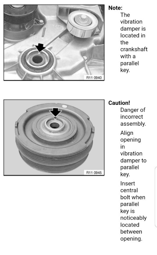

Salut, cel mai probabil ai pus fulia gresit, ea are o cheita care intra in piesa aceea de la vibrochen. Daca ai cheie speciala pentru fulie nu mai trebuie blocat vibrochenul. Simeringul este de la vibrochen, nu are treaba cu fulia.
damper.
8lYRcTW Note:
The vibration damper is located in the crankshaft with a parallel key.
8XAnfrD Caution!
Danger of incorrect assembly.
Align opening in vibration damper to parallel key.
Insert central bolt when parallel key is noticeably located between opening.
8VMybW8 Installation:
Mount vibration damper and align opening to parallel key.
Install new central bolt.
Position special tool 11 6 310 on vibration damper.
Protect engine bracket from damage.
Insert wood between engine support and special tool 11 6 310.
Tighten down central bolt

Ti-a raspuns ali inaintea mea. Se pare ca nu te-ai uitat bine pe spatele fuliei vechi. Avea ceva gaura in ea..
La mine nu a fost asa.
Nasol ca trebuie sa mai iei inca o fulie..
Sa ne spui ce ai folosit pana la urma sa centrezi fulia..
