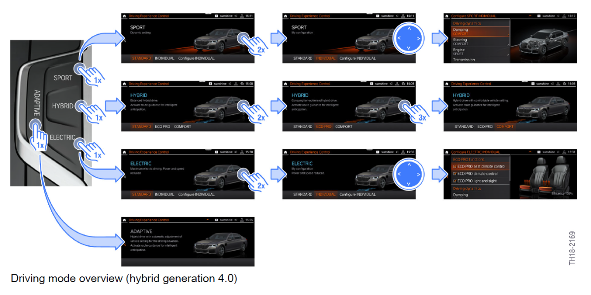

HYBRID GENERATION 4.0 DRIVING MODES.
OVERVIEW
In vehicles of hybrid generation 4.0, the driving and drive system modes are combined and simplified. With the newly
assigned Driving Experience Control, the ADAPTIVE, SPORT, HYBRID and ELECTRIC driving modes can be selected.
Each of the last two driving modes can be individualised with regard to efficiency or dynamics.
The separate eDrive button which can be used to shift through the drive system modes is no longer deployed. Its place is
taken by the Battery Control button.
The HYBRID driving mode is divided into 3 (only G11/G12 LCI PHEV) or 2 (G20 PHEV and G05 PHEV) predefined
versions or attributes. It is possible to shift through these variants by repeatedly pressing the corresponding button on the
Driving Experience Control.
Alongside the standard variant, the SPORT and ELECTRIC driving modes have an individual variant which the driver can
also shift through by repeatedly pressing the Driving Experience Control. In addition, these two driving modes can be
configured using the controller.
The familiar ECO PRO functions can be activated in the HYBRID ECO PRO and ELECTRIC INDIVIDUAL driving modes.
A shift of the gear selector switch to the manual position is possible in almost any driving mode. Here the combustion
engine is turned on and the drive adopts a sporty style (shift characteristic, accelerator pedal, etc.). The chassis and
suspension settings are not changed here.
It is only in the case of the ELECTRIC driving mode that manual shifting (also via the shift paddles on the steering wheel)
leads to a switch into the HYBRID driving mode with its last selected variant.
Astea sunt modurile care le am si eu pe G31 530e.
