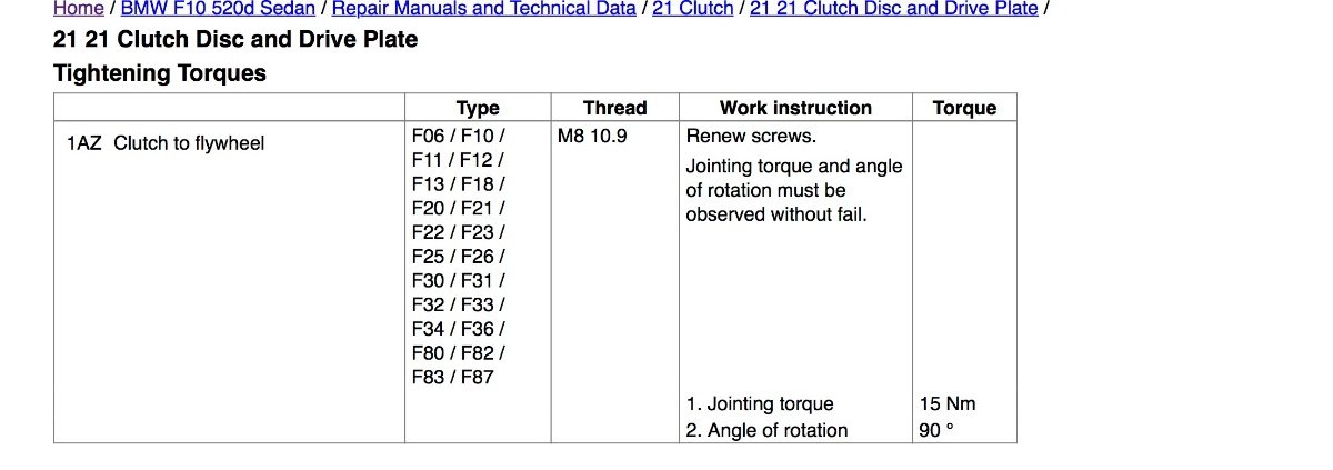

2 hours ago, Sorin_87 said:
Salut
Vreau sa inlocuiesc ambreiajul la un F10 B47 si as dori sa ma ajutati cu un workshop manual(TIS), daca are cineva.
Ma intereseaza cuplurile de strangere si codul piesei de centrare ambreiaj.
Din pacate newtis a fost inchis.😮‍💨
Multumesc anticipat.

36 minutes ago, ebay said:
11 22 Flywheel
Tightening Torques
  Type Thread Tightening specifications Torque
1AZ Flywheel to crankshaft
B47O0 M12x1.5 Replace screws. 120 Nm
1VnXo6cNTV
Manual gearbox.
Secure flywheel with Torx screw (1) and special tools 11 9 811 and 11 9 265 .
Release flywheel bolts using special tool 11 4 180 .
1VnYIr6cwY
Automatic transmission.
Secure flywheel with transmission bolt (1) and special tool 11 9 811 /11 9 265 .
Unfasten flywheel bolts.

1 hour ago, Sorin_87 said:
Eu vad doar tabelul cu volantul.
Orice link(cod piesa, tabel, etc) ma duce catre site-ul newtis, care e inchis.
Mersi.
21 21 Clutch Disc and Drive Plate
Tightening Torques
  Type Thread Work instruction Torque
1AZ Clutch to flywheel
F06 / F10 / F11 / F12 / F13 / F18 / F20 / F21 / F22 / F23 / F25 / F26 / F30 / F31 / F32 / F33 / F34 / F36 / F80 / F82 / F83 / F87 M8 10.9
Renew screws.
Jointing torque and angle of rotation must be observed without fail.
      1. Jointing torque 15 Nm
      2. Angle of rotation 90 °
