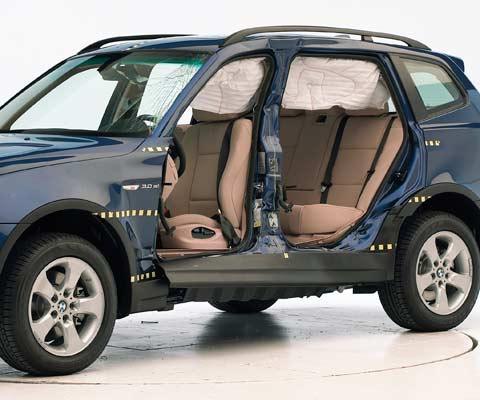

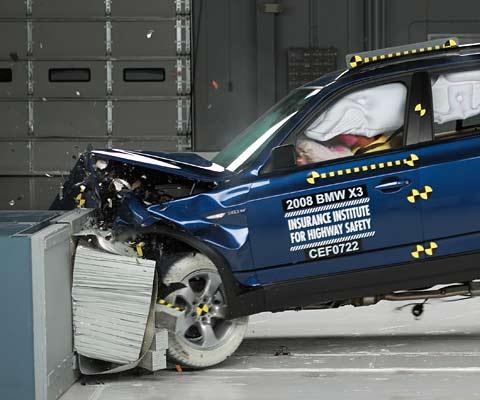

http://www.iihs.org/ratings/rating.aspx?id=876
http://www.iihs.org/ratings/rating.aspx?id=875
"Along with the X5, the X3 has now been fully tested in front, side, and rear tests, and has been adopted into the Top Safety Pick 2008 for midsize SUV."

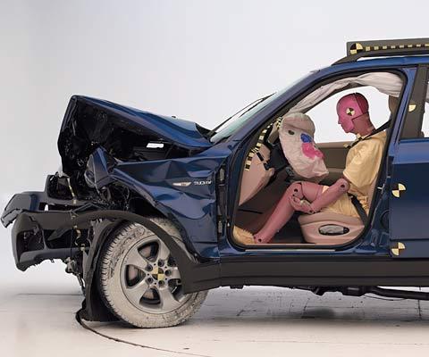

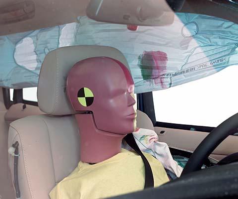

Front impact
The passenger compartment remained stable in the frontal test. Structures in the dashboard presented a risk of injury to the knees and femurs of the driver and passenger.

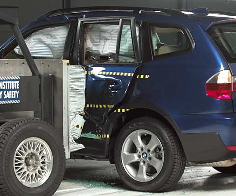

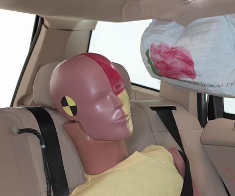

Side impact
In both the side impact and the pole test, the rear door became unlatched on the impacted side. The car was penalised as door opening presents a risk of occupant ejection. Based on the dummy readings alone, the car would have scored maximum points.
