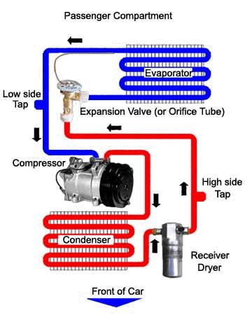

foto1 - ACa

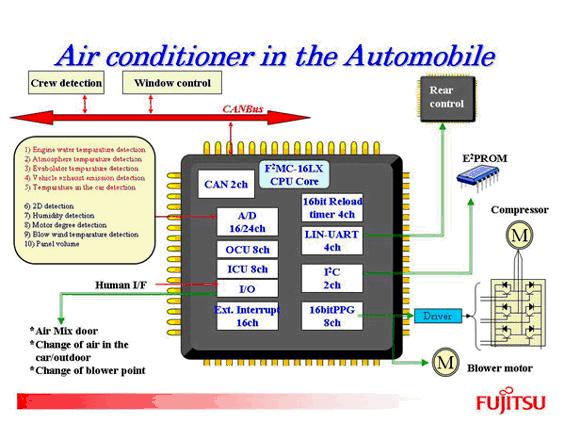

foto2 + 3 - ACb +ACb1

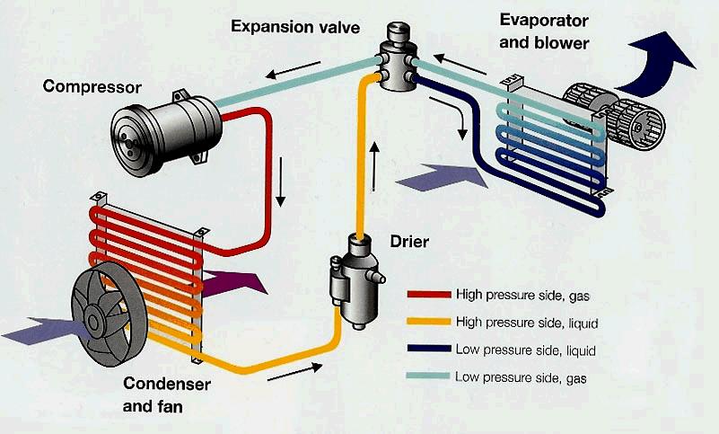

foto 4 - ACc
"It is recommended that you open the windows and door to give time for the interior to air out before you enter. Benzene is a toxin that affects your kidney and liver, and is very difficult for your body to expel this toxic stuff. "
