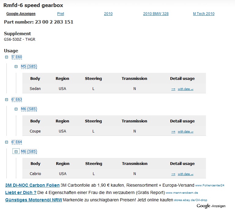

Asta vad ca scrie cand dau pe codul de la cutie de care am zis eu...
De aceea am si zis , cred ca e aceasta cutie ,ca din ce vad e singura care vine pe S85 (inafara de SMG)
Unul din proiecte , vad ca specifica acelasi lucru "..the infamous S85 M5 V10 power plant. This motor was chosen for obvious reasons and it's been matched up with the M5 6 speed manual transmission, differential, and half-shafts."
