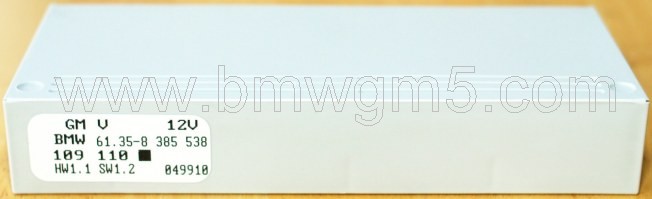

6. modulul COMFORT de 4 geamuri electrice (General Module - GM, part.no. 61358385538)
http://bmwgm5.com/Images/GM5_Case2_.jpg

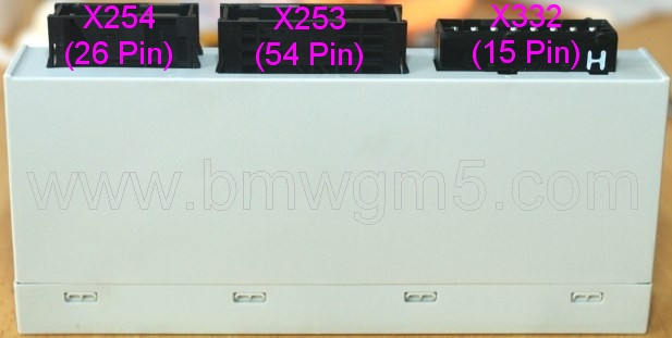

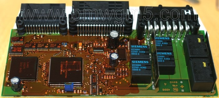

Chiar util pt mine acest DIY pt ca de-o saptamana am achizitionat macarale spate, butoane spate, butoane fata si trim.Dar nu am stiut ca trebe modul confort pt 4 geamuri electrice...nici macar nu stiu cum arata sau ce face acest modul.Baiatu de la care am cumparat piesele nu mi-a spus nimic de nici un modul:|
Imi puteti spune mai multe detalii despre acest modul???
modulul arata cam ca in pozele atasate... desfacut si cu precizarile de rigoare pentru ce face fiecare releu in parte...

"The larger ones are for the front windows and the two smaller ones are for the rear windows. I guess that explains why some GM5 modules are missing these relays. 2dr coupes don't need rear window relays."
"These relays are used in almost all GM5 modules found in the E46 3-series (except in some late 2004 and 2005 cars). Two relays used for the power door locks and should be replaced in pairs. Two relays are used for the rear windows, one per window."

eu am gasit o alta ordine a pinilor in mufa X254 cu26 pini... pe alocuri seamana cu indicatiile date de @robytza... dar sunt si diferente !
Pin assignments at plug connector X254
Pin Type Description / Signal type Connection / Measuring notes
1 E Signal, rear passenger's side power window switch, closed Power window switch, rear right
2 E Signal, rear driver's side power window switch, closed Switch block, driver's door
3 E Signal, rear passenger's side power window switch, closed Passenger's door power window switch
4 E Central switch signal, window regulator closed Switch block, driver's door
5 E Signal, status of antitheft alarm system Tilt monitoring
6 A Signal, tilt alarm sensor Tilt monitoring
7 E Signal, front lid contact Front lid contact switch

in mufa X332 legaturile corespund cu indicatiile lui @robytza...
Pin assignments at plug connector X332
1 E Supply for interior lights, washer pump, tailgate/rear lid release and load cutout Fuse F52
2 A Signal, washer pump Washer pump
3 A Signal, switch off consumer load Connector Load cutout
4 A Signal, rear driver's side power window motor, closed Window regulator motor, rear left
5 A Signal, rear passenger's side power window motor, closed Window regulator motor, rear right
6 A Signal, front passenger's power window motor, open Passenger's window motor
7 A Signal, driver's power window motor, open Driver's window motor
8 E Supply, front window regulator Fuse F48
9 E Supply, central locking system Fuse F60
10 E Supply, rear window regulator Fuse F71
11 A Signal, rear driver's side power window motor, open Window regulator motor, rear left
12 A Signal, rear passenger's side power window motor, open Window regulator motor, rear right
13 A Signal, front passenger's power window motor, closed Passenger's window motor
14 A Signal, driver's power window motor, closed Driver's window motor
15 M Load ground, central locking and window regulators Ground point
