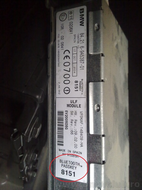

masina mea, un e46 325ci FL, are in dotarea standard kit-ul bluetoth si ce mai tine de el..cand vreau sa caut de pe telefonul mobil conexiunea cu acesta, imi cere un cod...de unde pot afla codul asta? :twoup: ..si care este procedura exacta pt a realiza conexiunea?
baga un cod de ex 00000 si la bluetooth-ul de la masina si la cel de la telefon si se vor conecta

Enter the password (= ULF passkey) located on ULF Control Module that is
in the rear of the vehicle or on the Passkey Reference Card.
· Mobile phone display shows ‘BMW …… Pairing’
· Mobile phone display shows ‘Pairing Successful’
· Display screen shows ‘Pairing succeeded’ for 3 seconds
asta am gasit in manual..
1. Press the menu button.
2. Select “Connect”.
3. Select option 3: “Bluetooth”.
4. Select option 4: “Options”.
5. Select option 1: “Operation mode” and set to “On” or “Automatic”.
6. Go back one step by pressing the red phone button.
7. Select option 3: “Discover”.
Mobile Phone display shows ‘Searching’
8. Select “BMW ……” in upcoming list.
9. Select option 1: “Add to paired”.
10. Enter password (= ULF passkey) located on ULF Control Module in the rear of the vehicle or on the
Mobile Phone display shows ‘BMW …… Pairing’
Mobile Phone display shows ‘Pairing Successful’
Board Monitor display shows ‘Pairing succeeded’ for 3 seconds
11. Enter device name.
12. Mobile Phone display shows “Added to paired devices”.
13. Quit menu by pressing the red phone/NO button for several seconds.
14. Once the phone is successfully paired to the
device cycle the ignition switch off and back
on.
15. The devices should wirelessly connect within
30 seconds. The connection is established
when the phone displays the symbols
indicated, on the right side of the screen.
Daca nu merge cu 0000 sau 1234 sau altele trebuie sa demontezi tot pana ajungi la ULF

Razvan ti-am explicat acum 3 luni cum sa faci Bluetooth Pairing :twoup: , nu ma ascultai :)
Daca nu rusesti ne intalnim intr-o zii si desfacem mocheta din portbagaj in stanga si gasim acolo pass key pe modulul bluetooth, dureaza 2 minute
Edited by edy1092
Desfaci mocheta din partea stanga.Si desfaci modulul bluetooth.Este situat deasupra de magazia de cduri sau MK4.Pe el o sa scrie parola.Este din 4 cifre.
